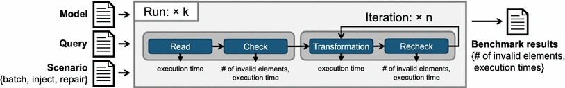

I'm currently exploring how I could measure the performance of my VIATRA-based solution. I would like to do it similar to the Train Benchmark [1]. Namely, load the model, load the queries and then simulate use case scenarios during which the model gets iteratively transformed/rechecked.
https://media.springernature.com/full/springer-static/image/art%3A10.1007%2Fs10270-016-0571-8/MediaObjects/10270_2016_571_Fig6_HTML.gif?as=webp
However, the initial read/check of my model takes quite a lot of time. The model is based upon real data and therefore quite complex. It would be ideal if I could make a deep copy of the engine, the resources and all found pattern matches. Then, I would only have to read/check the model once and I can use a copy for all use case scenario simulations. Is something of the sorts possible?
