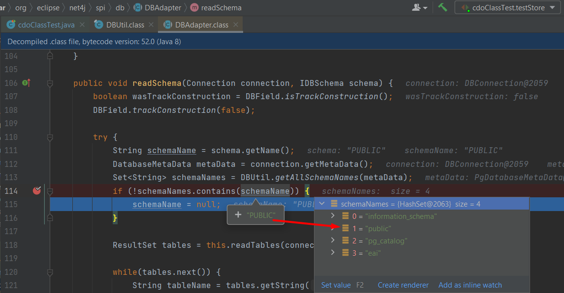

The battery_level_mapping table from the exception located in another schema, not in public but DBAdatper.readSchema() ignores the schema name I passed. Actually, DBAdatper.readSchema() recieves the schema name in UPPER case and then drops schema name to null and tries to read all tables in all schemas. It happens in the last if statement, in the code below Icopied from org.eclipse.net4j.spi.db.DBAdatper class because schemaName is in UPPER case and schemaNames contains schema names in lower case as they are in the database.

P.S. Also, you ca6n find the problem from the screenshot attached.

Re: Relation doesn't exists when executing CDOServerUtil.addRepository() [message #1860878 is a reply to message #1860877] Thu, 07 September 2023 02:10 Go to previous messageGo to next message
You didn't paste a stacktrace that shows how exactly you end up with the upper case schema name in readSchema(), so I can only guess that the call stack looks similar to this:

Re: Relation doesn't exists when executing CDOServerUtil.addRepository() [message #1860881 is a reply to message #1860878] Thu, 07 September 2023 02:46 Go to previous messageGo to next message
Perhaps you can find out why it's upper case?
It comes from org.eclipse.net4j.db:
public static IDBSchema readSchema(IDBAdapter adapter, Connection connection, String name, boolean fixNullableIndexColumns) {
        IDBSchema schema = new DBSchema(name);
new DBSchema(name) returns upper case schema name, so IDBSchema schema contains schema in upper case; however String name is in lower case. To be more precise, it happens in org.eclipse.net4j.internal.db.ddl:
