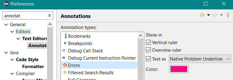

I have written my custom editor in eclipse and adding markers and showing annotations when any syntax error occured on save.
But how can I underline the problem text in red as in Java Editor. Can I do it via the annotation object or?

You'd make use of a marker annotation specification: https://help.eclipse.org/latest/topic/org.eclipse.platform.doc.isv/reference/extension-points/org_eclipse_ui_editors_markerAnnotationSpecification.html .

Do you have an example, I cannot find the configuration in the specification for native problem underline, see appendix pls what config I am searching for.
