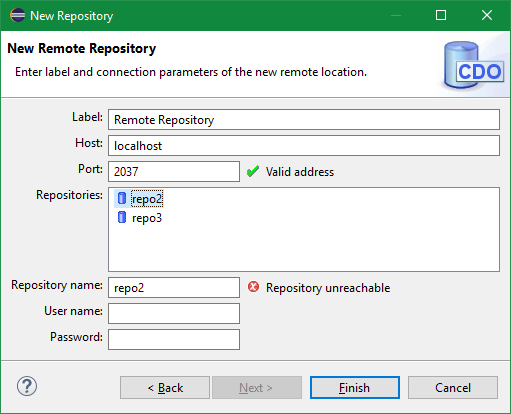

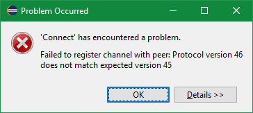

I'm currently evaluating Papyrus and have set up a local CDO server and a local CDO client. The server is running with two repos and I can see both in the CDO client, but when I select one of them I get an error message that there is a protocol conflict.
Because these are my first steps with Eclipse/Papyrus/CDO my question is: How can I detect which net4j/cdo version the headless CDO server is using?

If you have access to the server's console you can type "ss cdo", which should output something like this:
[INFO] CDO server starting
[INFO] CDO repository repo1 started
[INFO] Net4j extension starting
[INFO] Net4j acceptor starting: tcp://0.0.0.0:2036
[INFO] Net4j extension started
[INFO] Security extension starting
[INFO] Security extension started
[INFO] Repository configuration manager extension starting
[INFO] Repository configuration manager extension started
[INFO] CDO server started
Application started in : 1712ms
osgi> ss cdo
id	State       Bundle
5	ACTIVE      org.eclipse.emf.cdo.common_4.17.0.qualifier
8	STARTING    org.eclipse.emf.cdo.security_4.6.0.qualifier
10	ACTIVE      org.eclipse.emf.cdo.server.admin_4.3.6.qualifier
11	ACTIVE      org.eclipse.emf.cdo.server.net4j_4.5.2.qualifier
14	ACTIVE      org.eclipse.emf.cdo.server.db_4.11.2.qualifier
17	ACTIVE      org.eclipse.emf.cdo.server_4.17.0.qualifier
18	ACTIVE      org.eclipse.emf.cdo_4.17.0.qualifier
19	ACTIVE      org.eclipse.emf.cdo.server.security_4.9.0.qualifier
21	RESOLVED    org.eclipse.emf.cdo.examples.company_4.1.0.qualifier
22	ACTIVE      org.eclipse.emf.cdo.net4j_4.5.1.qualifier
24	STARTING    org.eclipse.emf.cdo.expressions_4.4.0.qualifier
osgi>
If there's no console you can look into the file <installation>/configuration/org.eclipse.equinox.simpleconfigurator/bundles.info
