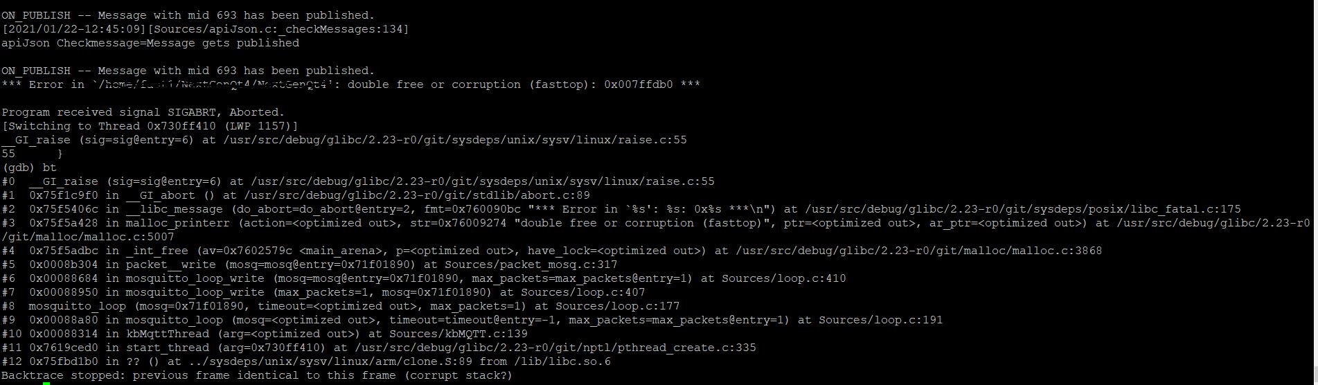

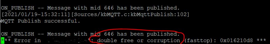

Hi Everyone,
I am using Mosquitto source code lib to create a MQTT client talking to test.mosquitto.org. The code will randomly stop after runs for several hours due to the "double free" error.
When this error happens, I can see two ON_PUBLISH callbacks get triggered and mids in both ON_PUBLISH are same. You can see this in attched picture.
My question is:
Why it has two same mid? Is it because message got re-published?
Any comments are appreciated!

Re: "double free or corruption" after publish message [message #1837147 is a reply to message #1837088] Fri, 22 January 2021 13:10 Go to previous messageGo to next message
Thank you for your reply!
Yes. You are right. The lib I used is from 2018.
However, I updated the lib this morning and had a same error. Please see attached picture.
Xiao
